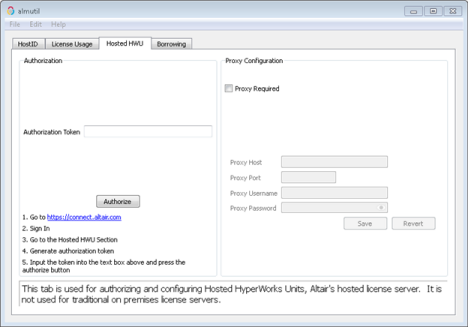

•For the GUI tool, select the Hosted HWU tab, paste the code into the text box titled Authorization Token, and click Authorize.
hw_intro_2017_01
